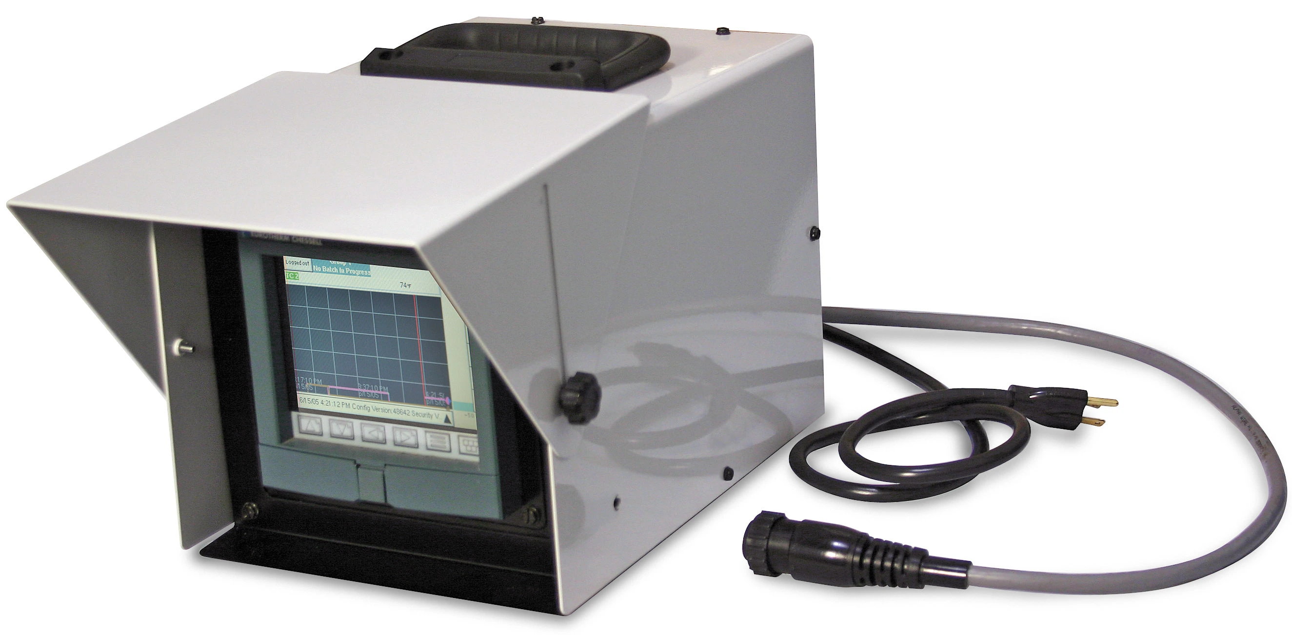

Twelve Inputs
Twelve temperature (0-10 V) inputs provide temperature data on the heating cycle
Touch Screen
The recorder is equipped with a touch screen for simple programming and use. The color display permits clear monitoring of the heating process in outdoor environment (direct sunlight).
Simple Data Transfer
Data can be transferred from internal memory to USB memory stick or directly to a PC via a network cable for printing, storage or further analysis. Files are encrypted for quality assurance.
Printable Logs
Simplified software prints recorded information onto standard letter-size paper (8.5 in. X 11 in.) for converting handling
Electronic Records
The recorder does not require pens, paper or fragile mechanical devices to document the heating cycle.
Portability
The recorder is attached to power source top panel or can be removed for office downloads, storage or protection when not in use
Simple Setup
The recorder power cord plugs into the 110 V auxillary receptacle on the rear of the ProHeat and the TC cable plugs into the TC receptacle on the rear of the ProHeat
