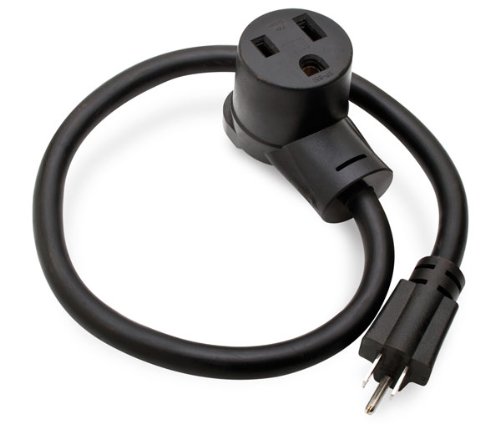

    I love them, don't own one, but love them. They make it sooooo easy to teach newbies. Diversions are very limited in range but that is what makes them so easy. A few people that had them learned fast and was so happy they upgraded to Dynastys.
    Just be aware that when you hit 1/8" material thickness things slow up. Light gauge and sheet metal, easy as pie.
    As far as extensions, I have the welder 220volt plug on the machine, a 50ft 220 volt extension, then an Eastwood 115volt plasma adapter. You could probably run a 115 volt 50 foot extension to the 115volt recepticle if that makes sense.
    Here is the Eastwood adapter. http://www.amazon.com/Eastwood-Versa.../dp/B007N6H29Q
