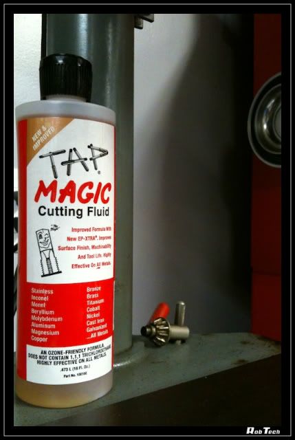

    Default Cutting Fluid
    Tap Magic x 2. Been using it ever since my uncles taught me how to properly drill on the farm many years ago.

    Thumbs up Tap Magic again
    I just drilled 4 3/8" holes into 1" thick steel in 6 seconds each (after setup) using tap magic. I was afraid of going faster because steel started flying everywhere! I also drilled 4 1/4" holes into 3/4" steel rod in 10 seconds each.
    Side note: The drill bits I was using were bought at ace hardware for $5 for the entire set! Not great bits! I used Pro Tap.
    Grainger sells it. Check it out at http://www.steco.com
    I didn't step up or down or sideways.
    Good Luck!
