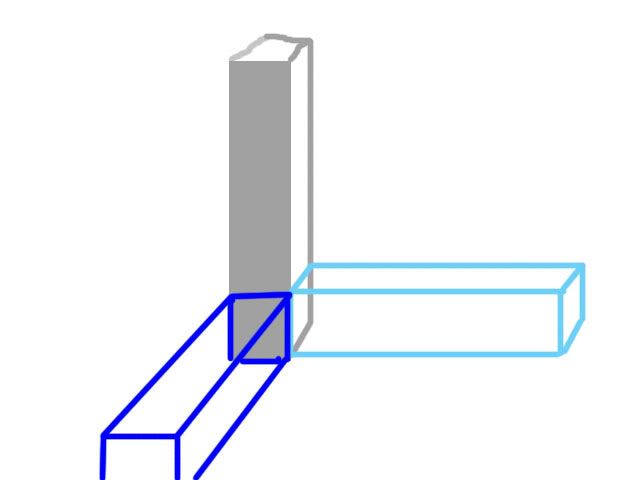

  10. #20
    Join Date
    Dec 2007
    Location
    Los Angeles
    Posts
    2,970
    Default
    Corner Joint
