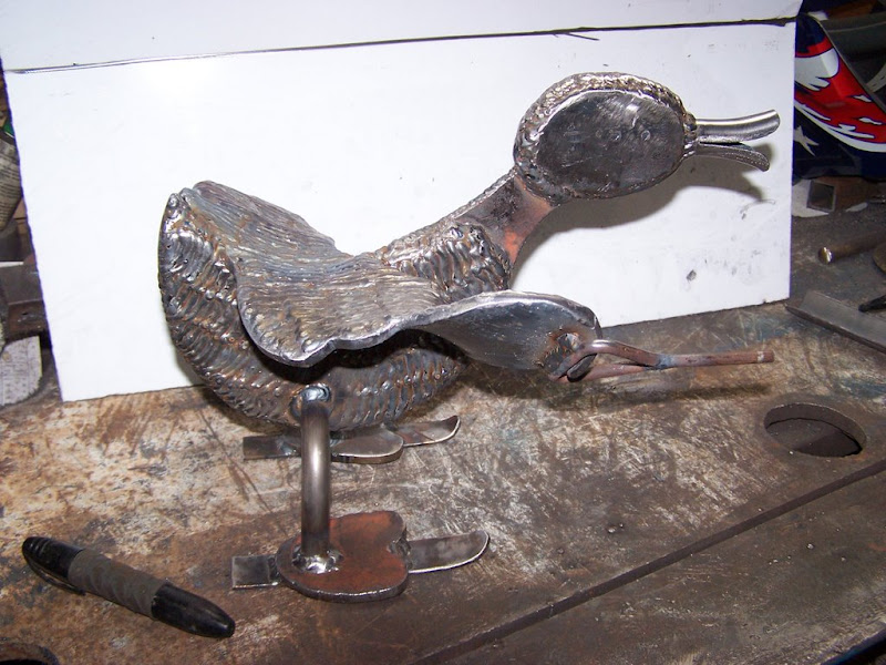

    After checking out Zann's website I couldnt wait to try my hand at
    the duck mailbox. I ended up using 1/8" sheet for the box portion.
    3/16" sheet for the roof, and 1/4" for the duck cutouts. The first real
    leason that I relearned was how important it is to clean the plasma
    cut before welding. Shezzz, the welds on a not so clean plasma cut
    is worse then forgeting to turn the gas on.
    The box part of the mailbox.
    Box part put togather with the roof just sitting there.
    Plain duck no feathers.

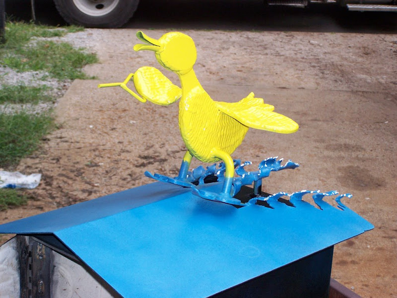

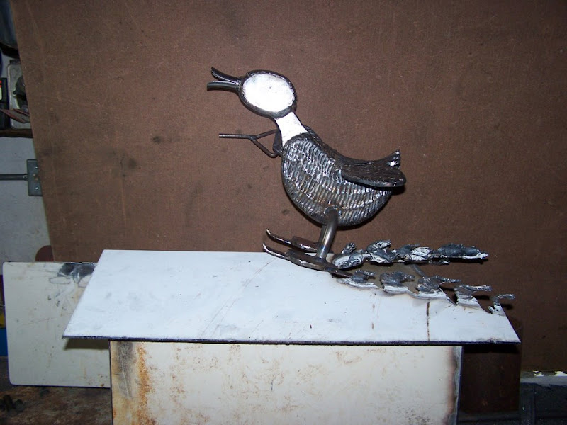

    The duck got feathers, a beak, and feathers too.
    The roof was a little tougher then it looked. I still have to work on the roof to get the front and rear gable for support, but its pretty close here. I spent about 3 hours yesterday and 6 or 7 today. Time flys when you are having fun.
    The waves should show up better when I get it painted. I should get it done tomorrow, then I have to find someone to sandblast it for me so the paint looks really good. My duck eyes should arrive tomorrow, the neighbor had to look thru a box and see what she has.

    The duck looks great so far, Tom. Were those waves hard to cut out?
  4. #4
    Join Date
    Nov 2008
    Location
    Kansas City Metro
    Posts
    387
    Default
    Thanks Spy.

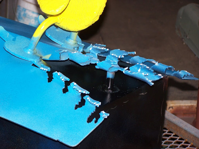

    The waves were harder then I thought they would be but not to bad.
    I thought that I was just going to cut out the notch's between the
    waves and bend them into a curl like a breaking wave. But there was
    not enough material to do that so I cut the triangle shape piece out and
    then cut the curls and welded them to each wave. I still have some
    sanding and some brush paint to do yet but its close.

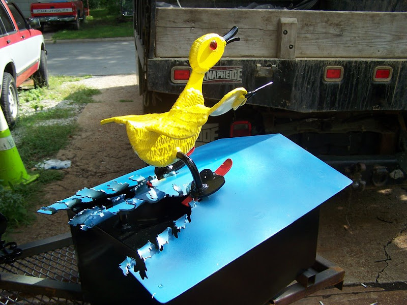

    Well here it is, ready to start catching mail. There is a few little details but all in all its done. Thanks Zann, without your site I would have never thought of something like this. Here is the last pic.
