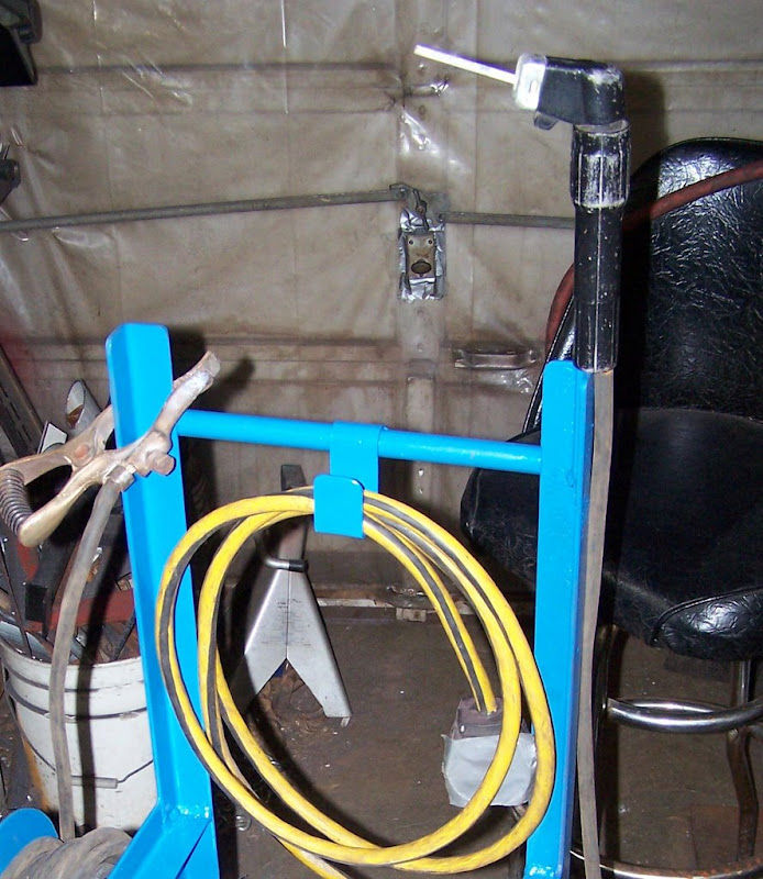

    Nothing fancy here. I dont have alot of room so I wanted to be
    able to stash the Stick-Mate away under a shelf when not needed.
    Also it will make it handy to roll out to the end of the extension
    cord and then I have 50' leeds to the street. It gives me enough to
    work if there is something on a trailer or just not enough room in the driveway.
    All done and ready to work.
    I threw this pic in to show the tweco connectors and the strain relief I used on the leed as well as the power cord.

    I like it, simplicity is a good thing.The lead hangers are cool, did you use pipe sawn in half? I cant tell from the photos please elaborate on the hangers .Thanks Mike

    The hangers are 3" EMT cut in half and the flat is 1/8" sheet cut to about a
    7" circle and cut in half. They are welded on the inside of the EMT since it seems when I weld in a place that I cant grind, everything goes to he!! in a hand basket. Murphy's Law I guess. But I only had one bad weld and it was because I had boogies in the nozzle and they took a dump right on top of a nice bead. You can see just a tiny bit of weld on the angle iron side where there was a small gap at the top.

    Thanks Tom, I appreciate the info.Mike

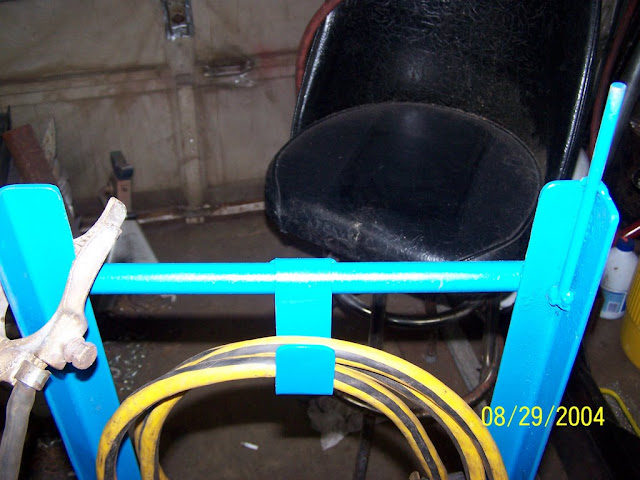

    I dont have a pic yet since the paint is wet and I cant hang the power cord. I went out there tonight and thought the cord looked half @ss hanging on the handle. So I bent a little tab and welded it to the center of the handle. Then used a 4" piece of round stock welded to the top edge of the angle on the stinger side of the cart. Just to hold the stinger so it does not fall and drag while I'm cruising around the garage. It was 2 tiny changes but I will try to get a pic loaded by Saturday

    Here is the last two additions. They arnt much but I'm sure they will get used every time I get it out.
    Paint isn't perfect but I plan on using it, and not having it in a beauty contest.
