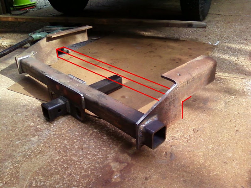

    I had actually thought briefly of supporting the front most portion of the receiver tube. Tho my thought was to use 3/8x3 angle. Now I am not sure that the angle has enough support the way I would place it. Maybe I need to use the square tube instead.
    Here is a pic of the placement I thought of.

    Hey there Tom That place that you have marked out in red is exactly where it needs to go. In fact weld a gusset on the side plates before installing your tubing. That will make up for the cutout of the side plates. Then your hitch will hold any thing your truck can.. Use 3" sq.tube 1/4" wall..

    In that application box tube is stronger than angle.
    FYI: 1/2-inch grade 5 bolt in shear is 14,730 pounds. 1/2-inch grade 8 shear is 17,870.
    I know you installed this hitch on a Ford, but if you add the box tube and just (4) 1/2-inch bolts I think even a built Ford tuff truck will fail first!

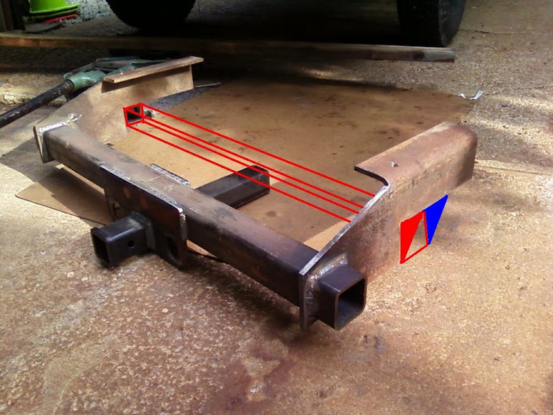

    I was thinking about the hitch after I posted last and I have to ask Urch, Was this where you thought the gusset should be ( the red triangle )? ? At the end of the square tube filling in the square corner? Or did you mean you would weld in the square tube and then place a gusset from the bottom of the tube up to the plate at a 45 degree angle ( the blue triangle ) ?

    Hey there Tom Weld the gusset where the red one is, and make it big enough or long enough to cap the end of the tubing. That in itself will add a lot of strenth add to this the tubing and you have your self an indestructible hitch. .. You said in an earlyer post that you barrow a dump trailer well one of my customers has a dump trailer and that is what twisted his hitch down. Dump trailers has the axles back real far and that adds tongue weight in itself... As far as bolts the most important bolts are the ones at the back side of the truck or the first set as you face the hitch. Most of the weight is on thoes threads, don't think of shear that's not the case, you can aways put a double row of bolts that take 90% of the load about two inches apart that should take any of your concerns away of the bolts. And yes I have seen bolts strip their threads and not shear off...
