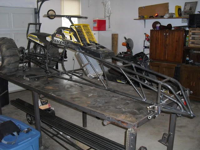

    just thought i would post some pics of some builds i have done recently....i did both of these for local builders....let me know what ya think

      what tube?
      Hi,
      you may have told us in an earlier post, if so could you repeat it please?
      Could you tell us what tube you're using? Size and wall thickness? And what do you use to bend and notch?

        i use alot of different tube size....1/2" 5/8" 3/4" 7/8" and 1 inch lol....just depending on what it is...i use different sizes for bracing and things, and for brake pedal ect....and i use .058 and .065 tubing although most of it is .058...and i live in west virginia....if i lived closer i would not have a problem with that no

              Are you in the "city" or the "hills"? I'm from Webster Springs, I have some property near Holly River State Park.
              On the tube, what flavor do you use, HRW, DOM, 4130? What are you bending with?

                i am frome parkersburg wv....about an hr from charleston....but i currently live right across the river in ohio.....about 5 mins from parkersburg....and i use molly on them....and i bend with a jd2 bender....nothing fancy its a manual bender but works very very well.....and there is no sand but these are built for strictly sand drags 300ft or less of a drag race....some tracks are dirt some are all sand some are a mixture of the two....fastest i have been in 300ft is 3.61 seconds at 90 mph....world record is 2.76 at 121 mph....thanks for your replys guys

                        I noticed some larger gaps in the fit up of some of your tubes. Does this present a problem when welding or create a weak point in the structure?

                              ddm are you deafman on planetsand? just curious...and im not sure where you see the gaps in the fitups....although if there was a large gap yes it wouldnt be very easy to weld....
