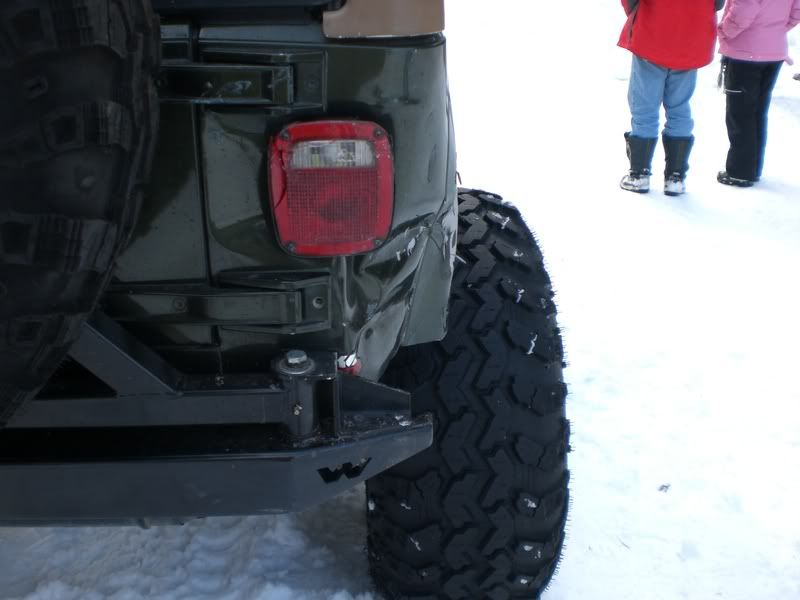

    Build a long rectangular flat sided thin wall box with non overlapping 90 deg corners incorporating ground down welds that is to be hung exposed, both inside the drivers compartment as well as externally under a rock crawling jeep and fill with gasoline. No foam, no internal liner, nothing to prevent the tank from flexing and splitting right next to a ground weld area in the HAZ. As the fuel sloshes and vibrates inside the tank it will cause the flat panels to flex like a 1 gallon paint thinner can. Unlike the thinner can which has seamless rounded corners and rolled lapped ends the corners on yours are stress risers. The stock was made from pressed steel for reasons more that economy and ease. The two halves are mated at the equator and the welds are planned so that they are not stress risers. The edges and corners are seamless and rounded.
    wtf?
    ok so on the side try to get through this....
    then on the back through this
    its happened before!!! bumper didnt move... now with the 3/16 corners i dont believe its somethin to keep draggin out...
    • #32
      ps that was from a mini yota truck doin fourty... as for the bottom.... it will have a minimum 3/16 steel skid it will be FINE. i do not see tabs to mount on my cell... i dont see the chassi splittin it up from the flex... it will be strapped! it is perfectly strong. the baffles act like gussets. drive over and punch it.... if it makes the smallest dent ill redo it

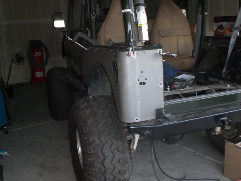

                some progress on the frame. the stock frame has a hole drilled and new fame slid in a couple inches and was plug welded. then fully welded. then i used 3/16th plate to even the surface and welded it up. then i will flap smooth and fish plate on all sides.
                • #38
                  and as of last night its lookin like this...
                  looks sweet in person... not done but its comin together
